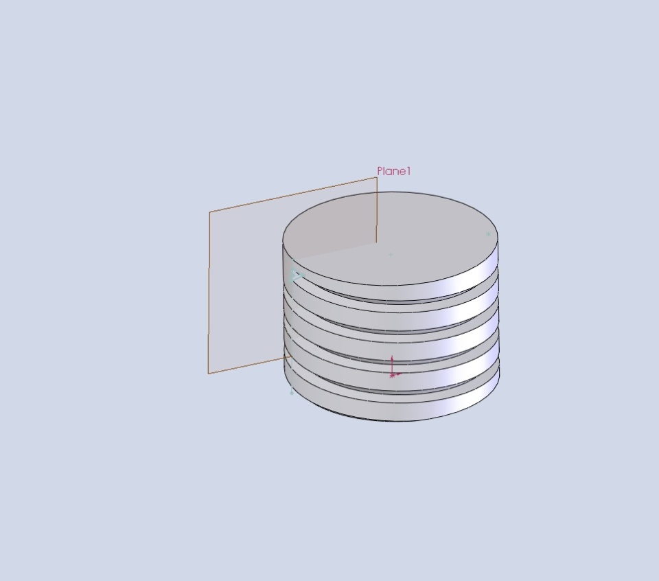

Now when I create a cylinder
put a helix on it
put a triangle that pierces the helix
and perform a sweep cut to simulate a thread, the model goescrazyand is completely screwed up.  I have done this hundredsoftimes before on SP2.2 with no problems.

I didn't have that problem. I wasn't able to select theprofile I extruded to make the cylinder to make the helix.Interestingly, doing it the other way, (making the helix first) Iwas able to share the profile sketch.
Anyway, I ran the cut sweep without any issues.

I tried this also and the model behaves as expected. Perhapsif you post the offending part . . .
