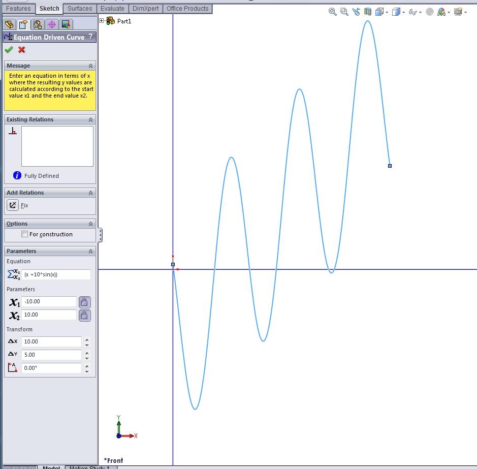

Upgrade to 2009 to get equation driven curves. Until then,your spline over a bunch of points is going to be as close as youcan get.

As Josh has suggested, upgrade to 2009 - it will give youexactly what you need.

From what I've gethered SW 09 does indeed have a way to enter anequation of a curve in a sketch. How does it work as far asstart/end points?
