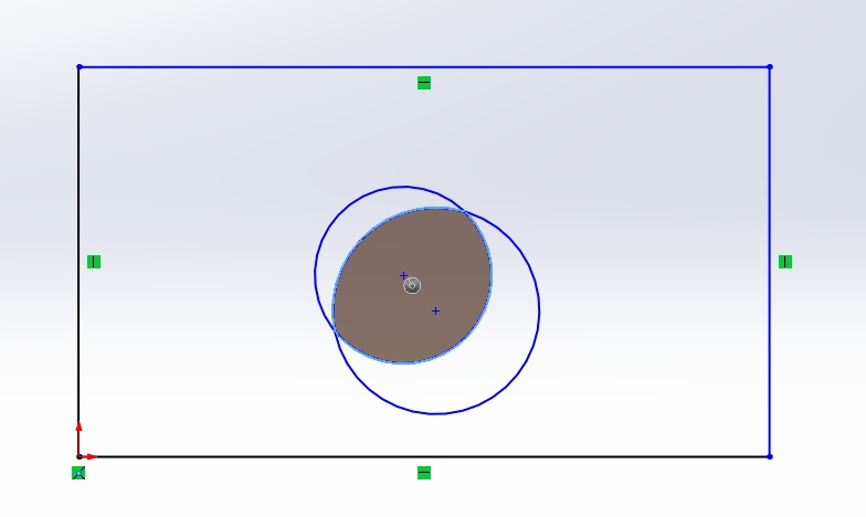

I have multiple sketch contours in the plane but i selected single contour to extrude.
While retrieving the extrude sketchsegments it returns all the sketch contours.
But i need only the extruded contour.
can anybody suggest it.
SolidworksApi macros
Comments 1
AT
AT 2013-05-08
Use the ExtrudeFeatureData2::Contours property. Here is the example: http://help.solidworks.com/2013/English/api/sldworksapi/determine_if_sketch_contour_or_sketch_region_example_vb.htm
