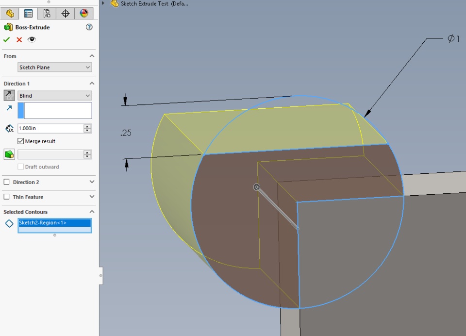

Sketch contour selection problem
Does anyone know how to stop existing geometry to interact with contour selection?
On this example I want to select lower part of the circle but body in the lower right corner doesn't let me to do it.
I know I can delete upper part and make lower part automatically pre-selected, but it is not an option in this case.

You should be able to click inside the corner and add it to the Selected Contours.

From the Knowledge Base:
"The basic purpose of contour selection is to quickly select sketch contours and model edges, and apply features to them. This allows users to use a partial sketch to create features"
So, you are asking for the sketch contours tool to NOT do exactly what is is meant to do.  You can simply CTRL-Select the corner area to add it to the selections and complete the lower portion of the circle.

SW2019 SP5:
When With the Selected Contours box selected (& nothing else), just hover the cursor over the contour. When it highlights click it.
Not visible in my images, but the cursor becomes a 2-button mouse with a green check on the RMB, but an RMB causes issues, do an LMB to select.
Once selected (with an LMB), it goes purple and you can still select additional contours, if required
