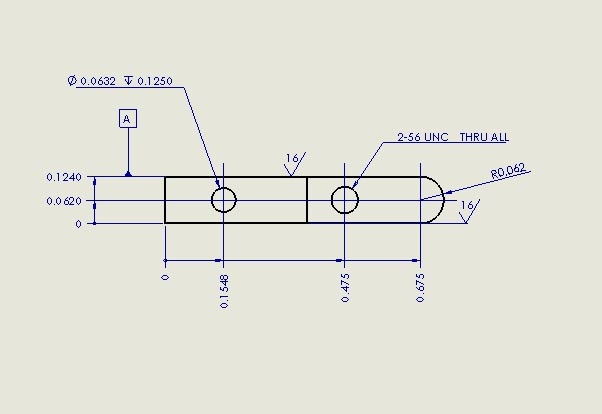

There are a couple of ways to do it.
The first suggestion I would have is to use ordinate dimensioning(everything based off a single 0,0 and you define a location withan x,y)
If you use base line you could highlight all the dimensions and goto properties/display and turn of leaders and extensions in mass.
This might also be a good application for dimensionfavorites.
SF
SF 2007-06-14
Try setting the drawing document detailing options to ISO anduse ordinate dimensioning. See attached for sample results.
SF
SF 2007-06-15
yes yes...  ordinate dimensioning is your friend...
Much better than a huge unreadable mess...
