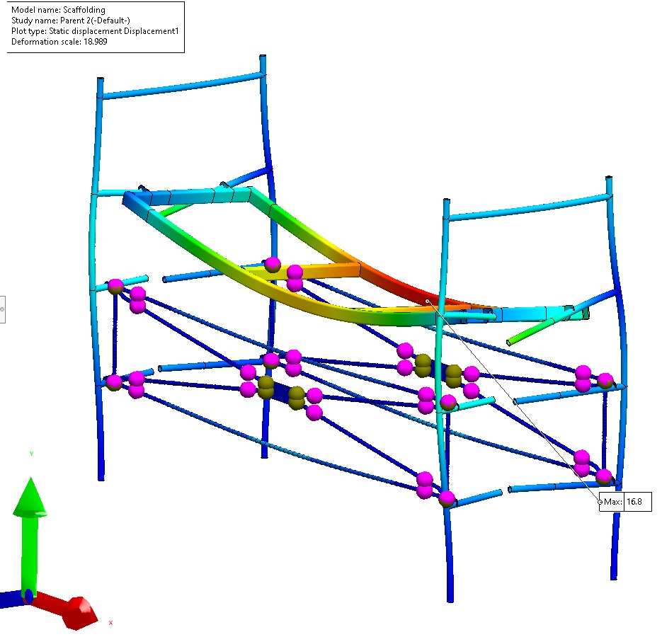

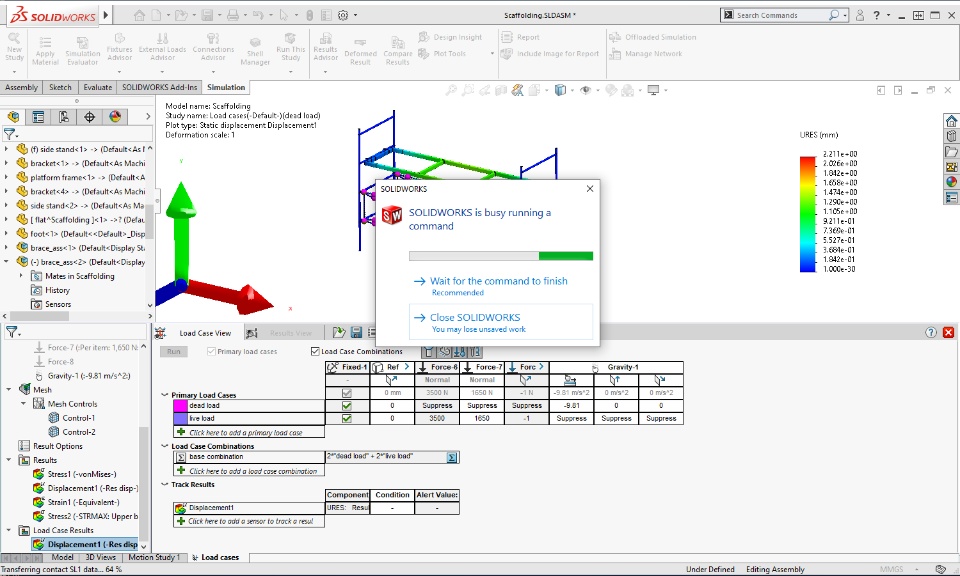

Lessons 04/05 of Simulation Professional - Load Case Manager & Submodeling
I was not able to get either of these lessons to solve. They also have some kind of obnoxiously huge Triad rendering on the screen:
I spent about an hour and a half trying to get either Lesson 04 or Lesson 05 filesets to work before falling back to just using the 2019 versions of those files, which worked fine in 2020.
Has anyone else encountered issues with these two lessons on the 2020 fileset? I wanted to ask before creating more SRs.
In the case of Lesson 04 - Load Case manager it runs but just doesn't finish to completion, it just gives up somewhere along the way
In the case of Lesson 05 - Submodeling I get model is unstable errors on the submodel if I try to use the existing results on the parent study. If I try to re-run the parent study I get varied results, such as this:
Thankfully these are the only problems I've noticed so far. I'm running SOLIDWORKS 2020 SP1.0

Jindrich Novak wrote:
 Please, make sure that when opening the file set, the option "Automatically update beam joints when study is activated" (Simulation\Options) is unchecked; you do not want to recalculate the beam joints because the file set comes with the results already calculated.
Jindra,
Thank you for taking the time to look into this! This was indeed the issue. I'm able to solve L4 & L5 effectively now.
I believe "Automatically update beam joints when study is activated" is on by default in a fresh 2020 install. Was there a note somewhere in the book to turn that off that I missed?

Hi Ryan, I tested the clean file set  for Lesson 04. I was able to solve the problem without any issues, and I obtained the results nearly identical to those published in the training manual. Please, make sure that when opening the file set, the option "Automatically update beam joints when study is activated" (Simulation\Options) is unchecked; you do not want to recalculate the beam joints because the file set comes with the results already calculated.
For Lesson 5, for the file set with results, please recalculate the parent study results, and then solve the submodeling study (or define a new submodeling study and solve it) - this is mentioned in the training notices solution. Again, make sure that the option "Automatically update beam joints when study is activated" is unchecked.
