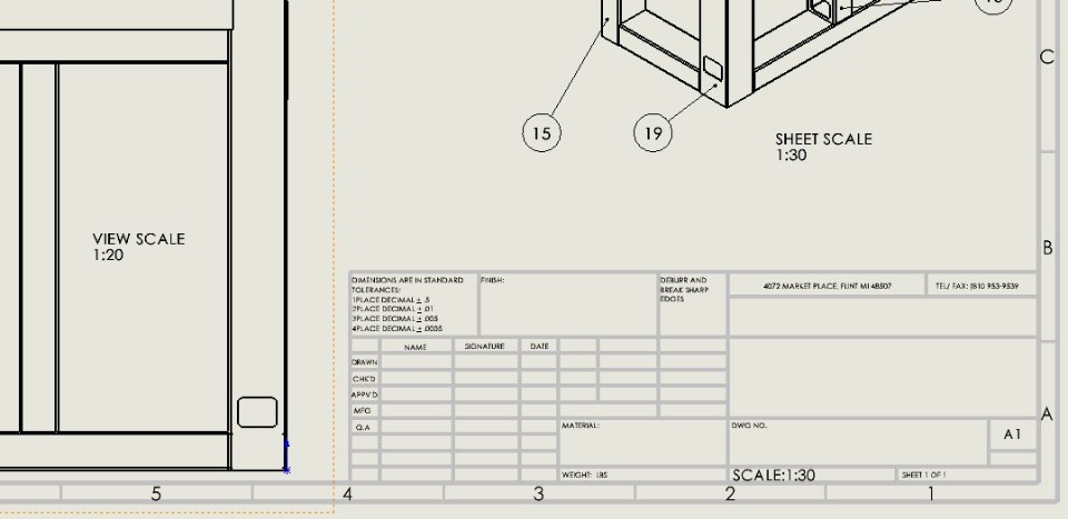

It seams to me if you look at the sheet scale in the title block you would think the normal views are 1:30 not the isometric view.
I know not much full size printing is done to allow scaling of the drawing but just in case someone did do I now have to label all the views as to their true scale?

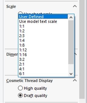

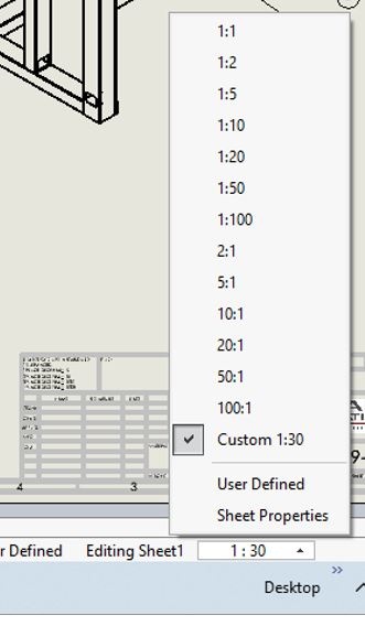

One left mouse click on the arrow and a box open that is the only place I can find user defined to set the scale but here it is the sheet scale this setting is new  in SW 2020.

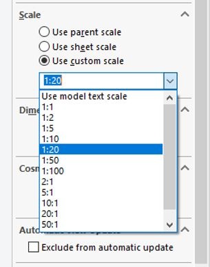

This is SW 2019 this is where user defined use to be before SW2020 this is the view scale setting as you know.
This is SW 2020 view scale setting I do not have the user defined setting does anyone have it?

So on the left panel if you right click on a sheet, you can define what you want the whole drawing on that page will do. then you have to edit each view if you want it changed from the drawing view default.​

In 2020, you can just type in the scale in the text box.  Don't need to select User Defined.
