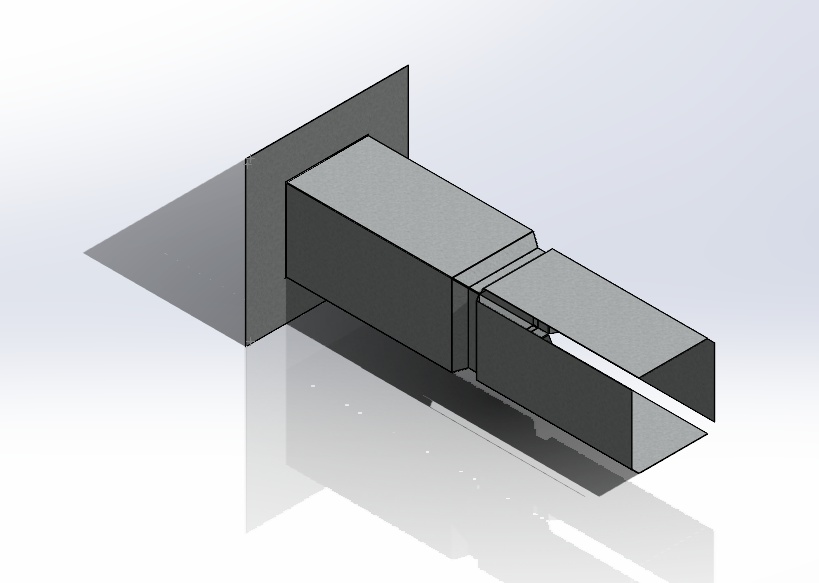

Hi, Can I make something like the attached shape by SolidWorks Sheet Metal. My initial thoughts were to split it after making this shape and flatten each of the split parts for production. But, the parts is giving error during the making it flat. Can anyone help on this? Thanks

Mike, I found that issue that the problem starts from first bend. If I do break the parts into four initially, is there any way to maintain the flange angle and shape for the rest of the bending?

As others have said, you need to rework your model to what's feasible and practical.
This can be one piece, but the bottom square must 4 [non-]mitered flanges off the end of the square tube.

While I agree with Kevin that this could be done in one piece you need to also think of the press brake operator. I just created a part and looked at it when finished thinking that the operator would be chasing me with a pipe wrench if I sent that design to the floor. Time to change the design.

What they are telling you is shown in this example.

Can you post your part file, or at least a screenshot with the Feature Tree fully expanded?
I can't tell for sure if you have only one body or several.

what I'd like to do for those kind of parts is using "Convert to SheetMetal", based on a simple volume body and using the MultiBody-capabilities of SWX:

Mike, Please see the attached screenshot.

You're going to have to break it up into multiple bodies.  Then you can flatten those individual parts.

You have only qty. (1) body. It will intersect if you try to flatten it, hence the error.
I pity the press brake operator that bends that one.
EDIT: I opened your file. Your problems start with the first edge-flange and it gets worse from there. What you're trying to do won't happen in the real world. You'll have to break it up into at least two bodies.

Still getting the flat pattern error after splitting
