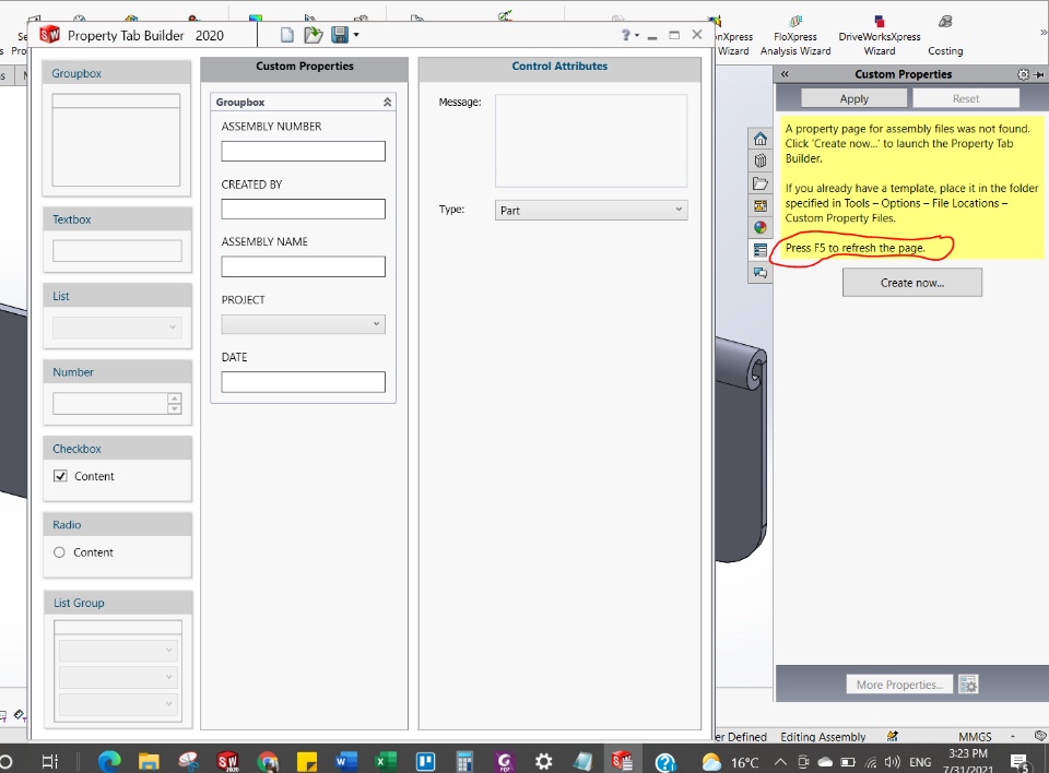

I was trying to setup property tab for assembly module. As the first step, I created the ".prtprp " using property tab builder tool.
But, Its not getting loaded to the assembly module even after pressing "F5"
Hi Experts
You created a template for Parts not for Assemblies. For Type select Assembly and save the new template.
If you created your PTB template for the wrong type, you needn't recreate it for the required type.
Just edit the extension from prtprp to asmprp.
It's the same file structure (XML) and I believe SW just loads the template for the current file type by the template's extension (since the file name can be anything, not just the default "template").
