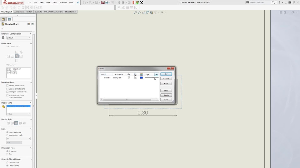

Hi, sorry to bring up an old post, but i seem to have the same problem and the posted solution doesn't  work.
(changing the document properties doesn't have the desired effect)
Below is a screenshot of the layers window for two different .drwdot files. (Drawing template files)
in the top one, there is no active layer. Any dimensions and annotations added to this drawing are on layer '-none-'.
In the bottom one, the invisible layer is active. Any dimensions and annotations added to this drawing are on the invisble layer.
I want the bottom template to work like the top template, but i cannot de-activate the invisible layer.
I have tried creating a new layer, activating it and deleting it. But that does not seem to work either.

That's because you always have to have at least one layer active. Since you're deleting your dummy layer, the invisible layer is your only choice. Don't delete your dummy layer just turn the invisible layer off and make sure the layer you want is active.

You can make a new layer and then delete the new layer.

Hi Tony, that's what i figured should be going on. However, the top example does not behave like that. There is one layer present (blue, invisble) but it is not active. Annotations and dimensions are added to layer '-none-'

thanks for the input, i tried your solution but it does not yield the desired effect. I made a short video of what's happening.
When adding a new layer, and then deleting it, Solidworks automatically makes the remaining layer active.
I'm starting to think that having no layer active in one of my templates is a 'bug' i'm using as a feature.

-none- is just that meaning no layer, this just means that everything you add is being added to the workspace, the same space your model is being added to. If you want to add it and be able to format it by color, line style or line width, etc, etc then you need to create a layer, format it and then make sure it's selected when your adding to your drawing. Make sure your layers toolbar is open and select the layer you wish to work in from there. The toolbar will have your -none- as well as -per standard-     -none-  cannot be formatted, -per standard- is set through the document properties
JO
JO 2017-08-29
Roger, I was unaware there was a layers toolbar where i could select -none- and -per standard-. I think this is the solution i was looking for. Thank you very much!
