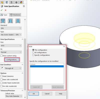

I have a part with more than 1 configuration, and I have a hole wizard hole in that part.
I want to set the hole size for a given configuration scope (this/all/specific), just like one can do with dimensions using IDimension.SetValue3.
So I'm basically looking for a method like IDimension.SetValue3, but which sets the hole size of a hole wizard hole instead. Does such a method exist? And if no such method exists, how else can I achieve this?
What I currently have is this:
1. I take the IWizardHoleFeatureData2 and call AccessSelections.
2. I call IWizardHoleFeatureData2.ChangeStandard to set the new size.
3. I call IWizardHoleFeatureData2.ModifyDefinition and finally IModelDoc.EditAssembly (on root model doc).
It does set the size, but I have no control over the scope using that method. It always uses the current scope, i.e. the one that is selected in the attached image.
So is there a method that allows me to set the scope manually before going through the steps above? If there is, that would solve my problem as well.
Any other ideas or hints?
