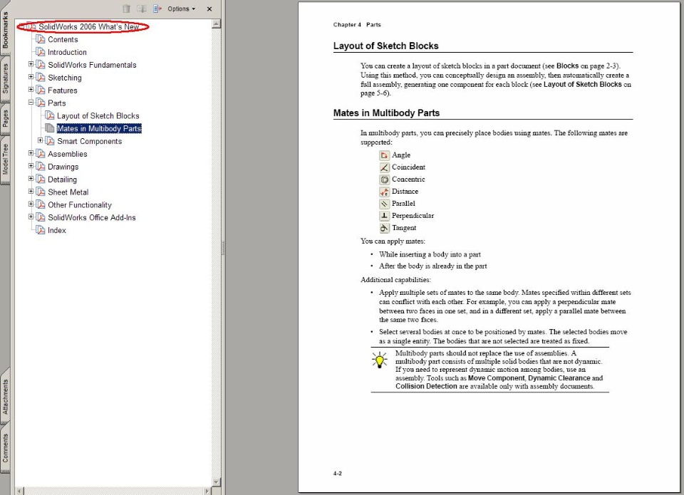

actually "mates in multibody parts" were introduced in 2006.
see solidworks 2006 what's new (pg 48 of 134).
