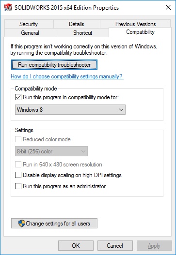

Run SolidWorks 2015-16 Student Edition (2015 SP 2) in Windows 10 (In Windows 8 compatibility mode).
  1. Upgrade to Windows 10 and make sure you have installed all updates. (This may take a few restarts.)
  2. Install SolidWork2015 SP2 form your DVDs/Download. Ignore the warnings about Windows 10problems. (I had to do this then repair the installation)
  3. SolidWorks will now open but you cannot start new/open a file without it crashing.
  4. Right click on  the SolidWorks 2015 shortcut or executable file and select properties, the bottom dropdown item.
5. Tick/Check Compatibility mode and Select Windows 8 from the dropdown menu below. (Note you do not have to have had Windows 8 or have upgraded from Windows 8 to do this, I upgraded from 7.) Press Apply then OK.
6. Run SolididWorks 2015. (You can restart first if you choose but I did't have to ).
7. You will get a prompt asking if it ran okay in Compatibility Mode after the first time. Answer appropriately.
It appears to be running fine for me after a couple of days use and much quicker than SolidWorks 2014 in Windows 7, on an identical machine.
