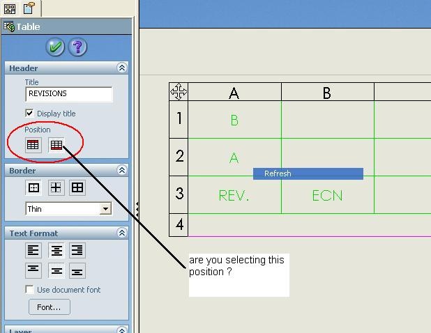

This is probably a minor gripe but:
if the Revision Header is placed at the bottom of the table I wouldexpect the revison rows to increment upwards, just as if you wereadding a row on a hand drawing. SW builds it as if the header rowwas at the top and the top revision is always no. 1 (or A).
Is there anyway of changing this?

Mine revision table is working fine.Are you selecting the properoption.
I had this happen to me today... ended up having to delete the table and remake.
Did you set up the option for the header properly. If you can replicate the issue, please submit it to your VAR.
Yes. Will send to VAR too..
