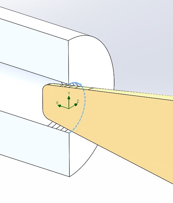

Hi,

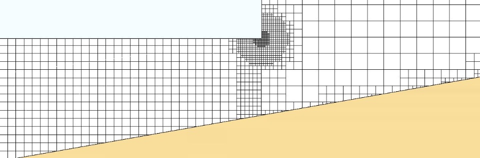

im in a needle-valve simulation and try the find the minimal pressure in the system. This will be around the corner (see in Picture) but i cant determinate/read out it excatly: Problem is when i do not interpolate the cells, it shows a bit unrealistic and looks like it depend of where the cubes are trimmed: the XY-plot follow the pattern of the trimming.
When interpolate is checket seems more balanced but can i do an interpolated XY-plot ?. How can i show the real pressure along on the edge?

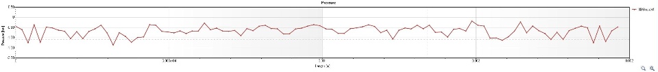

pressure on along the edge:
finer mesh do not help anything, (and with this resolution curvature option also dont)  this pattern looks like always the same.
