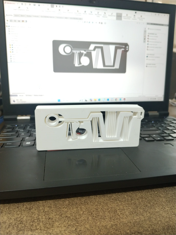

I recently explored Compliant Mechanisms—flexible structures that achieve motion without traditional joints. Using SOLIDWORKS, I designed a single-piece mechanism and brought it to life via 3D printing!

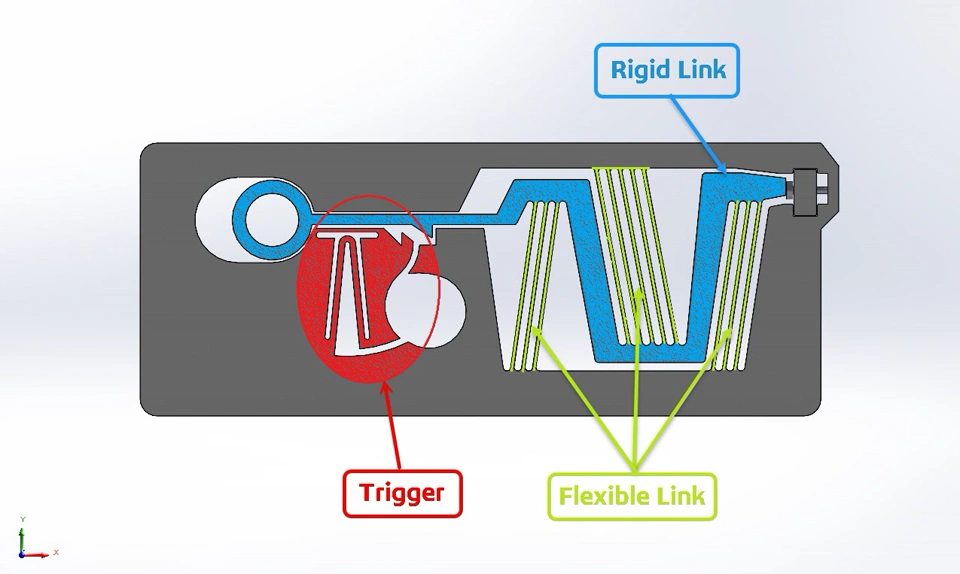

🎯 How It Works:
To engage the trigger with the extension of a rigid link, the circular end of the link is pulled until it engages with the hole.
Once engaged, the flexible links undergo elastic deformation, bending rather than breaking due to their reduced thickness. These links function as compliant springs, storing and releasing mechanical energy efficiently.
Upon releasing the trigger, the stored elastic energy in the flexible links restores them to their original configuration. This controlled deformation facilitates a straight-line motion transfer to the rigid link, ensuring smooth and precise mechanical operation.
