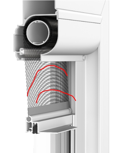

Reducing Moire Effect/ Patterns in Solidworks Visualize
Has anyone using Solidworks Visualize ran into the Moire Effect in rendering out materials with patterns? My screen renderings have distinct patterns showing up that I wouldn't expect on rendered content that I need to remove. I'd like to avoid changing the camera angle, screen mesh size, or focal length to try and fight it like on a digital camera. Does anyone have a fix? @BH @BH Thank you.

Hi Luke, in photography you would be using a smaller aperture or lowering the sharpness to remove it.
Without changing the camera position, can you artificially soften it with a small amount of Depth of Field but with a high enough F-Stop value to not blur out the model too much?
At a slightly longer shot, can you use the accidental 'smudge' effect from the denoiser to bring this down? With the material choices I'm guessing that your final render only needs to be in the 100s of passes, so possibly a 100 pass render with the denoiser kicking in at pass 99?
It is reassuring to see Visualize rendering so physically accurately that such visual effects can occur! However I guess this is one of the very minor downsides of an unbiased render engine
