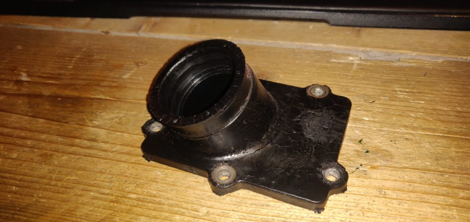

Hi,
I am trying to recreate this object in SW 2020. Tho don't know how to get started on that tube thing. Where would I start. Which features would I use or what sketch technique? The tube is oblique in the x and y direction (horizontal plane). Really appreciate any help!

RK 2021-03-26
Hey, I'm getting quite far at this point. Tho I am having some difficulties recreating the angles as accurate as possible. I'm going to try to describe as best as I can why it's so dificult to get it exactly the same. In order to determine which dimensions (10, 10, 26 at this moment)  I have to measure using calipers (at least that's what I am using rn). The red dots in image 1. show the relative points. Tho I can't really point at these dots on my physical object, which I need to be able to do in order to determine the height, width and height of course. This makes it really difficult to measure. What would be perfect is to specify the following dimensions in SW (image 2: red green blue). These a,b and c are easy to measure on my model. But how?

WS 2021-03-26
See part 2.  The centerline axis of the tube was done with a 3D sketch which can be changed by changing dimension.

RK 2021-03-26
I see where you are getting. But the tube like thing also bends to the right. The angle you see in the left picture is correct. But it needs another angle, but SW doesn't allow me to create such an angle as the line will then not lie in the plane.
