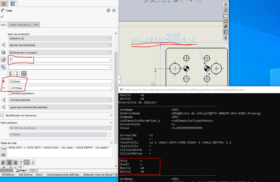

I don't have problem selecting all dimension, but I can't read it correctly. In next picture, I show you my problem:
As you can see, I can't read the tolerance. For mare help, the tolerance was defining in the part of de drawing.
