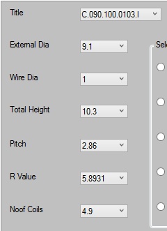

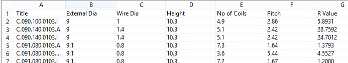

Thank u for reply. I went through the link what you have provided. And here i found that at the end it is returned to specified values.But actually what i need is if i select the Title then other parameters such as External dia,Wire dia,...,No of coils should select automatically & then i have to use finish button to create the model.Please have a look on the form design & table.
