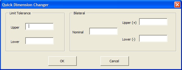

I am always looking for something to help me save time and always looking for examples on how other people do things so I just thought I'd share my new userform to change a hi/low or bilateral to a symetrical tolerance (we model to nominal by default)
I have set it up as a shortcut to the macro on my keyboard so I can select a dimension and run it quickly.
Here is a screen shot of the UI:
you only have to have a dimension selected and it will convert the value and apply the tolerance with increasing the precision if required over the documents default.
Enjoy. (and if you have any comments/criticisms please let me know)

updated version attached... this one doesn't blow away any prefixes, suffixes, etc you may have put in place before, it ONLY changes the dimension value and the tolerance.
