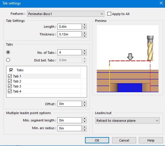

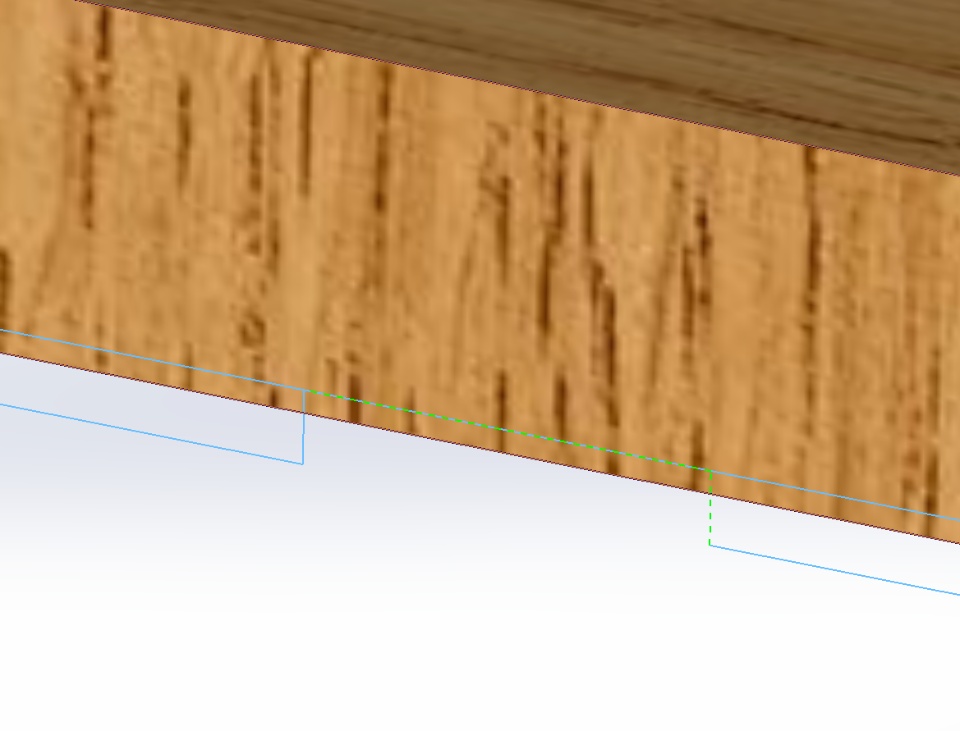

Cutting 3/4" plywood without a vacuum table. Need tabs to keep the plywood together during the final contour cut. 3/8" Compression bit. Ramping down in one move to full depth + .003" beyond stock. When attempting to use Tab Cutting to have the machine bunny hop over the tabs, I am given a toolpath that ramps down to the depth of the top of the tabs, runs around the entire part, then ramps down to the beyond stock machining depth (.003") and THEN performs the bunny hopping I was expecting.   Is this by design? The preview sure doesn't make it seem that way.
What am I doing wrong?
