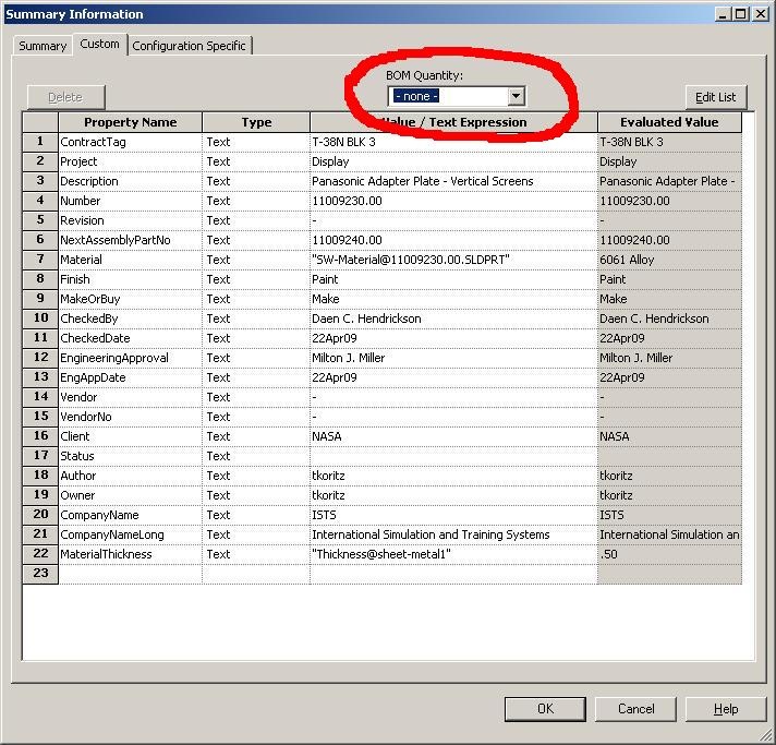

Is it possible to have the quantity of a part come directlyinto a drawing sheet? I'm thinking something along the lines of\\\$PRPSHEET:{QUANTITY}.SolidworksDrawings And Detailing

i dont think this is the method you are looking for --> inthe properties of a part you can specify which property todesignate as qty in BOM. that way when you create a bom on a partdrawing the quantity will display with whatever number you desire.
i think you are looking for a note??? if so, you could just linkthe note to a property that has the quantity. but you would have toenter it manually and if updates occur - that would also be amanual process.
