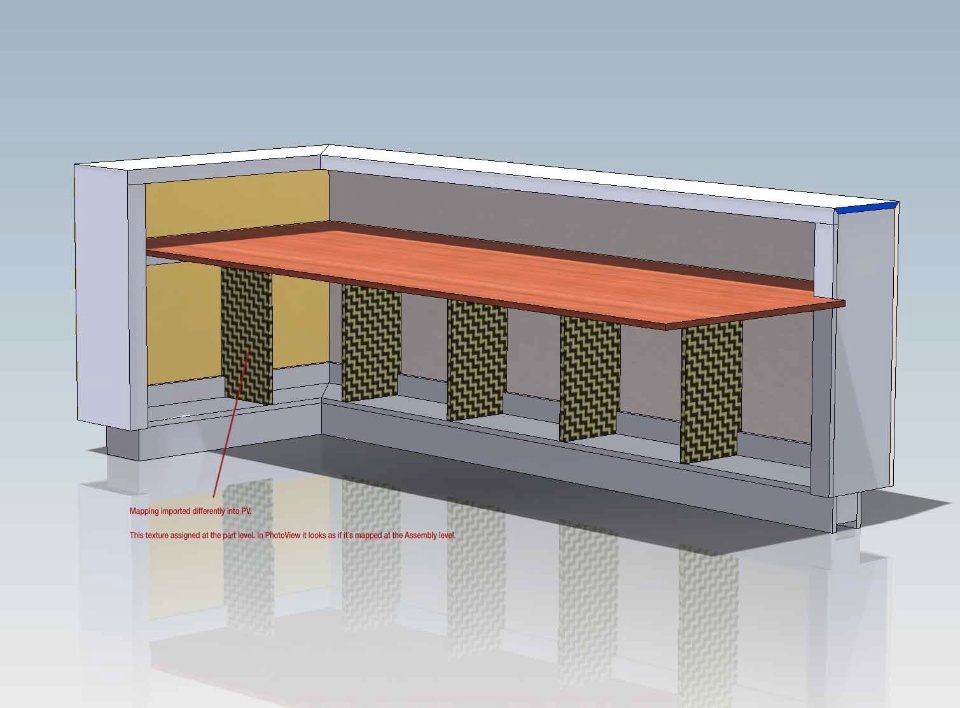

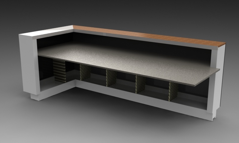

I've applied some textures at the part level, cause nothingis showing up at the assembly level in either direction (PV to SW -SW to PV). Only one appearance has made it into PV from RV eventhough I've assigned materials to many parts of this assembly. Ihad previously assigned appearances to parts in PV and saved fromPV, but those do not show up in the parts or the assembly in SW.The appearances assigned in PV did show up again in PV when theassembly was reopened, seemingly overiding the appearances assignedin RV.
In the two images, the one texture that did show up in PV from RVwas assigned at the part level to a part that did not have anassignment previously from PV. The screenshots show that themapping in PV seems to have been applied at the assembly level inPV where the screenshot from RV shows the texture applied at thepart level.
