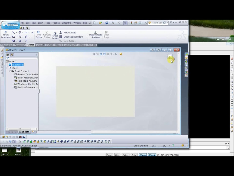

I'm creating a drawing and need to insert blocks.
Every time I insert a block SW decides to add some text to the block.
I've created blocks from SW drawing views and then inserted them into a new drawing.
I've create a sketch of a circle in a blank SW drawing, saved it as a DXF file.  Then inserted it into a new blank drawing and SW decides to add some text.
I've create a square in Draftsight, saved it as a dxf file, then inserted in into a blank SW drawing file.  SW decides to add some text.
The text inserted is not random.  It's 2 notes that we use on most of our drawing templates

video attached

Good video Tom.
I noticed you were working in the sheet format.
What happens if you insert the block into the regular drawing sheet?  Does it still pick up your notes?

Notes are picked up in either, in the sheet or on the sheet.
I have tried a couple of  solidworks blocks and it does not pick up the note.  DXF or DWG are the only things effected.
