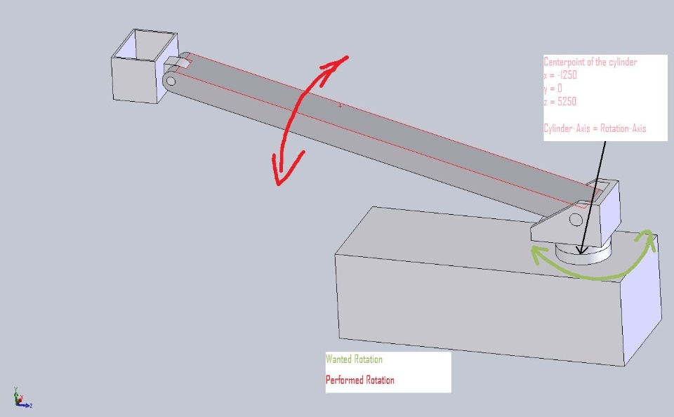

I'm writing a student research project at the University ofPaderborn about an automatic movement transfer to a cad program -in this case Solidworks 2007 Student Edition - at the moment.
According to this I tried to develop an interface to theSolidworks-Api, which shall run the rotations within the cadprogram. Unfortunately the result does not represent the aimedmovement. Perhaps I made a mistake or I have a mistake in thinking,because the movement does not follow the aimed axis at all.
The rotation in the following C++ code should be around the y-axisbut it is performed around an axis located somewhere in thex-z-plain (see Attachment). The centerpoint of the rotation is thecenter of the cylinder located at the top of the cuboid, which'sposition is (-1250, 0, 5250):

I hope you can help me with this somehow.
