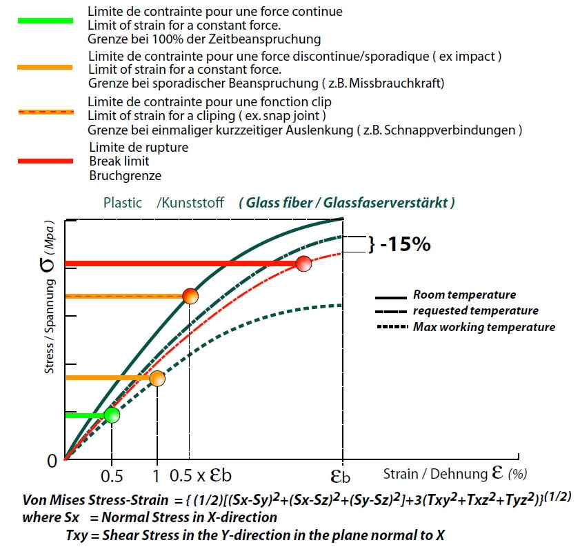

hi,
we are doing many nolinear simulation with plastic part, and mostof the time we are taking the Von-mises curve from Campus. We haveto creat each time the material ! it not the best but after acouple of month we have most of them available.
Of course ba doing this we are considering the Part as isotropicand have to take some safety coeficient ( about 10% below thelimite given in Campus ).
I did an overview for the limit we are taking depending of thesituation and the typ of constraint ( see attachment).
regards
