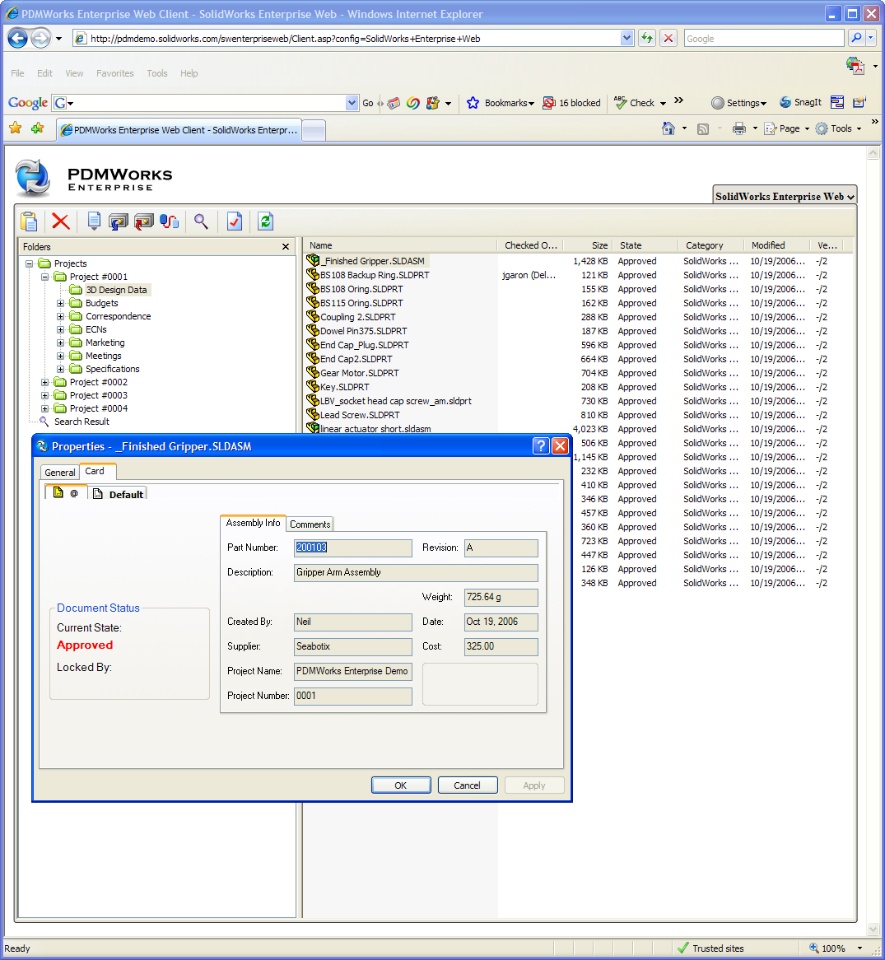

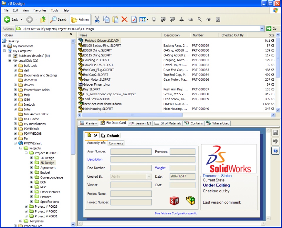

The Contributor and Contributor Web clients are different in acouple of ways.
The Contributor client is a 'thick' client vs. Contributor Webbeing a 'thin' client. This means that the Contributor client mustbe installed whereas the Contributor Web client is acccessed via aURL, login and password. The first time a Contributor Web clientconnects to the vault an activex control installs the client.
The clients also differ slightly in what the user can do. TheContributor Web client does allow users to check in and check outfiles however, the UI is different. (see attached images) You willnotice the bottom right panel in the thick client does not exist inthe web client.
