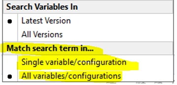

PDM 2020 SP5 Is there any information how these options highlighted in yellow work or what they do? Below the "Search Variables In" I also have "Match search term in..." options which are "Single variable/configuration" or "All variables/configurations". I have not found anything about these help, What's New, User Guides, or blogs for PDM 2020 or 2021.

Presumably, the first option will return a result if the variable value in ANY configuration in the file matches, and the second option will return a result only if the variable value in ALL configurations match.

This video explains the difference before the option was introduced.  "All variables/configurations" matches the behavior when using the colon (:). https://youtu.be/Y9SqcjLPfAM
