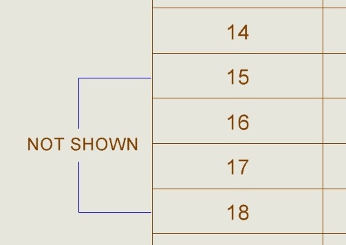

I'm looking for suggestions on adding a note next to my BOM to identify components that aren't shown. I currently add a note saying "Not Shown" and add lines if it is a group of components. I was hoping to just add a column and merge hide cells that aren't related but that isn't working well. Looking for a better not floating in space solution.

We have a column with no border lines where users can type in NS​.  This allows the note to move with the part.
comment imagecomment image
