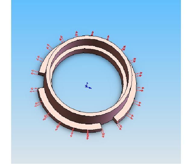

I am trying to simulate the deformation of the(copper)ring when a tensile stress is applied to the OD ofthenon-slotted area. Apply only the normal stresses andnorestraints will give me a  message of "Not EnoughBoundaryConditions" when I execute the analysis. I do notwant to (fix)restrain any of the surfaces because it wouldcompromise the result.
Does anybody know how to apply the appropriate stresses/boundarycondition to simulate this scenario ?

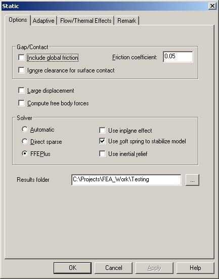

Have you tried the "Use Soft Springs" option in the studyproperties?

I suggest the restraint on a face oriented normal to the axialdirection be held constant with respect to the axis. so it won'tslip along the axis. but why would it anyway?...you haveaxisymmetric pressure. The pressure may be axisymmetric but themesh definetely may not be but may still be dense enough to provideuseful results within convergence criteria. The point here is thatthe mesh isn't necessarily perfectly axisymmetric and small nonzero forces can cause acceleration. This type of restraint is meantto have little effect on the tangential stress results you probablyseek since it can still deform radially under this pressure.

Just a quick refresher... Use Soft Springs when a model hassome restraints, regardless of direction. Use Inertial Relief (SameStudy Properties dialog) when there are NO Restraints. Mixing theseup can skew the results.
