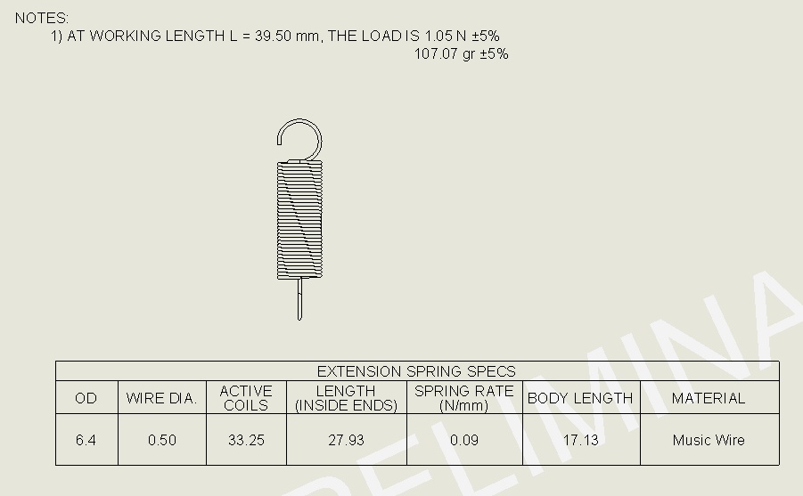

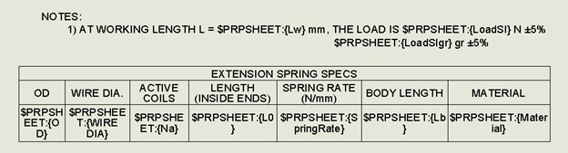

How to link the spring parameters from 3D model to 2D drawing
  1. In your drawing template, create a general table, say 3 rows x 7 column
  2. Link the CusProp from your spring 3D model (see the last row in the att. image
Open the drawing template and insert the spring. The table will be filled up - see sample image
