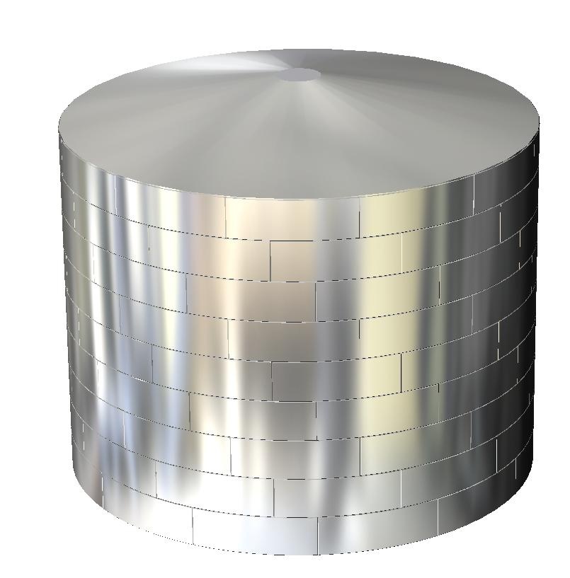

Any body can give me advice how to design astorage tank with multisheet metal wall like image below ? the diameter of tankis about 21meter and the height is about 17 meter.
What is the best method ?

There are probably several ways to do this. For the attachedsample, I modeled the tank using a simple revolve. I then split theresult into 2 body files (roof & wall).
Next I opened the wall part and cut the ring to make it into acurved panel. I opted to use a 15° cut to set the arc length.If you wanted to specify the length of the arc and drive the angle,then you just edit the dimensions to be driven the other wayaround. 15° was convenient later when making the assembly.
In order to make the curved panel into sheet metal I created a veryshort planar extrude. That throws the accuracy of the model of by.001m, which is probably acceptable.
Using that short extrude as a reference face, I inserted bends intothe wall panel so that it can be flattened. I chamfered the edgesjust for show and tell - otherwise the JPG wouldn't look very cool.
Finally, I created an assembly with component patterns of thepanels and dropped on the roof. I didn't bother making the roofinto sheet metal. That's something you could do if you wanted.
The point of all this is that if I go back and edit the diameter ofthe original revolve, the other parts should update to the newsize. If you change the height (1.8m) or the length of the arc(15°) then you'd have to edit the component patterns in theassembly to match the new part size
Since we wanted the panels to be sheet metal - something that canflatten- we ended up with an assembly of sheet metal parts. If wewere just making solids, we could have just split the originalrevolve into a lot of bodies and left them all in the same partfile, but that's an entirely different topic.
Using a master body with split parts is a nifty way to do contextbased modeling of components, but you have to remember how you didit. When you come back to this next year, it may be frustrating toremember which part gets edited to accomplish the desiredchange.
