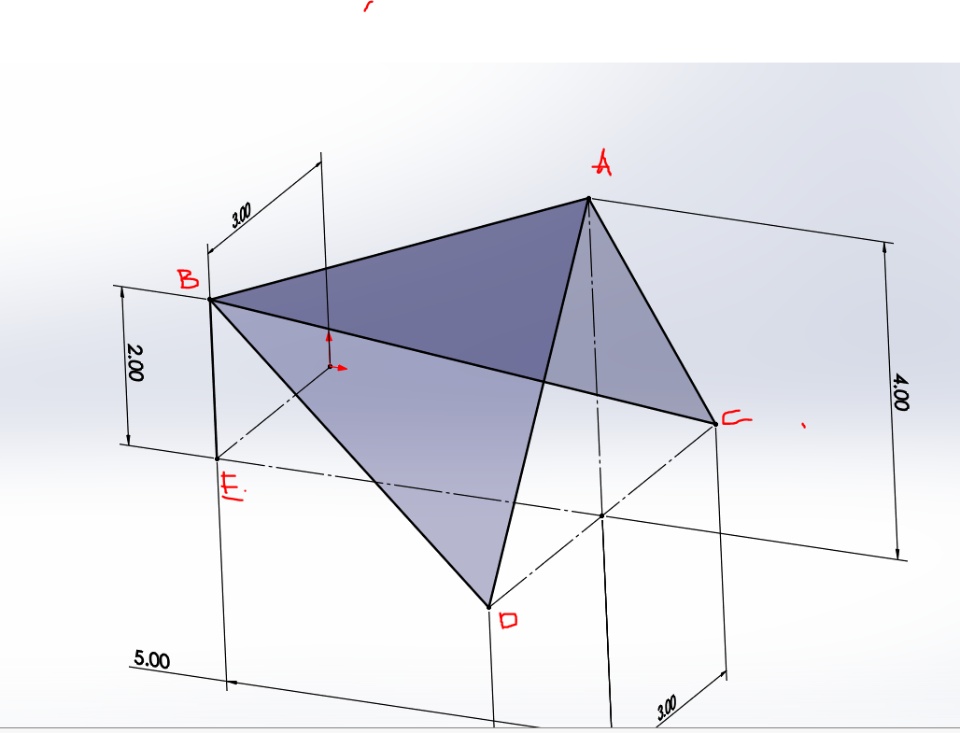

Hi Experts
Is there an option to give names to the points in the 3D sketch as shown in the snip ?
Try this
https://www.youtube.com/watch?v=6u5o-5Evug8&t=12s
Hi Basil,Another option is to use a note. The advantage here is that you can use a leader to the point on the 3D sketch.A disadvantage is that the notes are placed on a plane and don't keep looking at the user like dimensions do.
Try this
Hi Basil,
