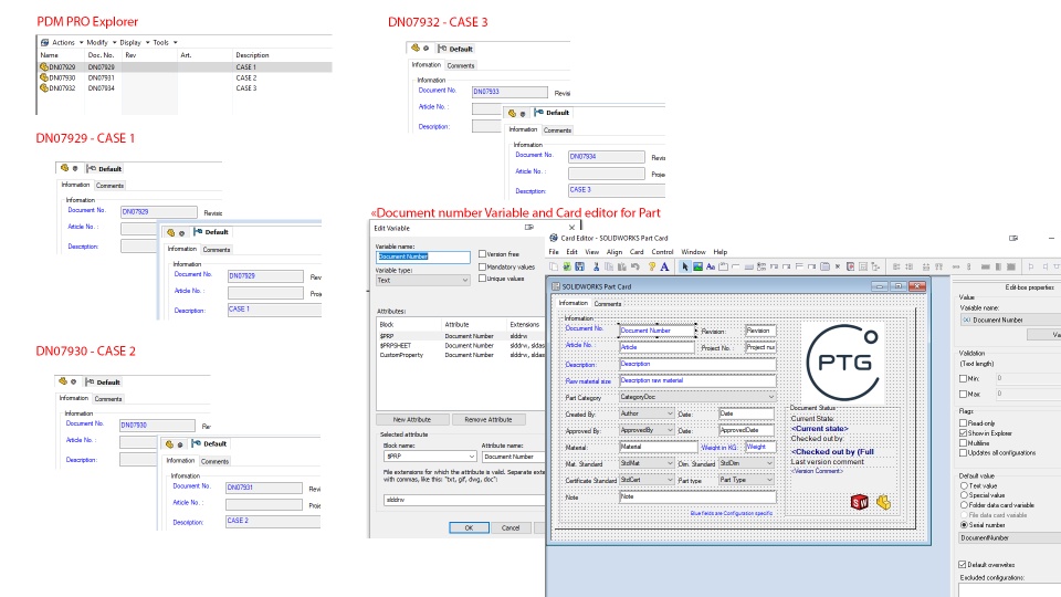

I got a serial number which will be used as "document number". which i would like to be on parts and configurations, even tho i work mostly in one part one configuration mode. Only utilizing configurations on library part. I am working on the PDM implementation in my firm, it is not yet released for other workers.
All cases is the same file (for demonstration purposes), only one configuration, the start configuration.
Case 1 (-This is what i want basically )
   If i create a part in solidworks, it seems to work fine.  @ , Default and part file name get the same number, and i am happy. I can call out "document number" in \\\$PRPSHEET and get the same value in drawings etc.
Case 2 ( unacceptable )
   If i pull parts from my "desktop" in to my vault, suddenly i get a number in @ configuration and a new number in the "default" tab, filename is still the @ config number. resulting in two numbers ? This is annoying since these numbers get mixed up bad, drawings based on this file will get the filename after  @CT \\\$PRPSHEET link in the titleblock will pull the default number.
Case 3 ( this is chaos )
   If i "copy tree" the file in vault, and rename the file to serial number (Have activated unique filename for all files, dont want duplicates) i get three numbers now ?? the filename,  @ and the default get a new number? resulting in a real cluster****
Does anyone know what to do ? i am clueless at the moment. See attached picture for details.

This seems to be a bug in SW 2019 SP2.. i have now updated to SP3 and the problem is now gone ?
I had my local reseller look in to it, but they have yet to confirm the error or what wasnt working.
When i now copy parts, they get one and only one number pulled out.

the @ configuration behaves as the parent for the default.  Default behaves as a derived configuration.  If you put a value in the base configuration and keep the derived configurations empty, then EPDM/SW will go up the tree until it finds a value.

You need to have the "update all configurations" box ticked to avoid Scenario 2 happening as otherwise it generates a new number for each configuration.
For Scenario 3, you need to decide on how new parts are going to be named, generally I name my filename as the serial number, and have the actual number field on the data card, set to "File name without extension" as the default value.
