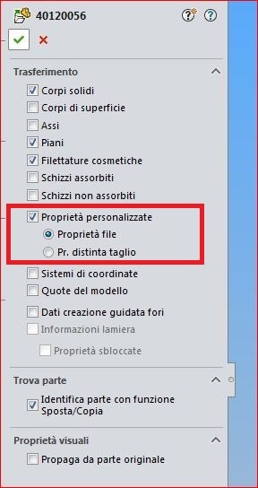

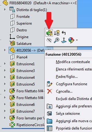

I have a lot of multibody parts (part inserted inside a part) where inside the import function is activated the import flag of the customproperties import. I need to swith it off and the idea is to write a macro due to the big amount of files that need to be changed. I have recorded the macro, but it seems not working. Is it accessable this flag throught API?
This is my code on SW 2020:

boolstatus = Part.Extension.SelectByID2("40120056", "BODYFEATURE", 0, 0, 0, False, 0, Nothing, 0)

swDerivedPartFeatureData.ImportModelDimensions = True    '<<<swDerivedPartFeatureData.ImportAxis = True                          '<<<TrueswDerivedPartFeatureData.ImportCustomProperties = 3  '<<<< NOT WORKING
boolstatus = swFeature.ModifyDefinition(swDerivedPartFeatureData, Part, swComponent)

I tryed to change other properties of this function, but this property is not a bool and is not changing...no problem with the bool.
