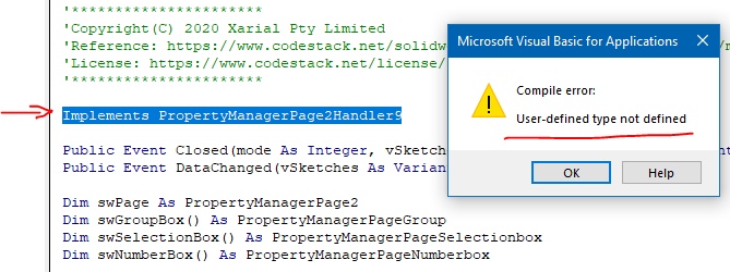

If I create a solidworks part (sketchs) similar to their example part, I get a "User-defined type not defined" error when I try run the Macro (See Attached).

Hey Scott,
Have you added the 'SolidWorks 20xx exposed type libraries for add-in use' reference to your macro? This is the first thing that comes to mind.
From the SW API Help:
"To use this interface:
In a SOLIDWORKS VBA macro, you must reference the SOLIDWORKS exposed type libraries for add-in use type library specific to the version of SOLIDWORKS that you are running."
https://help.solidworks.com/2021/english/api/swpublishedapi/SOLIDWORKS.Interop.swpublished~SOLIDWORKS.Interop.swpublished.IPropertyManagerPage2Handler9.html
AT
AT 2021-07-08
@SB, Austin is correct, you need to add this type library (I have updated this macro at CodeStack to mention this explicitly in the article).
If you are planning to use the macro feature I would recommend trying the COM-based macro features in .NET (C# or VB.NET). This will allow you to build robust features. You can use xCAD.NET framework which makes it much easier to build macro features: https://xcad.xarial.com/custom-features/​​​​​​​
Take a look at this video from my presentation at 3D Experience World in 2020 which demonstrates how to build macro feature from scratch (9:30 mark, but you can see the full video as it also shows how to create add-in): https://www.youtube.com/watch?v=BuiFfv7-Qig&t=570s
