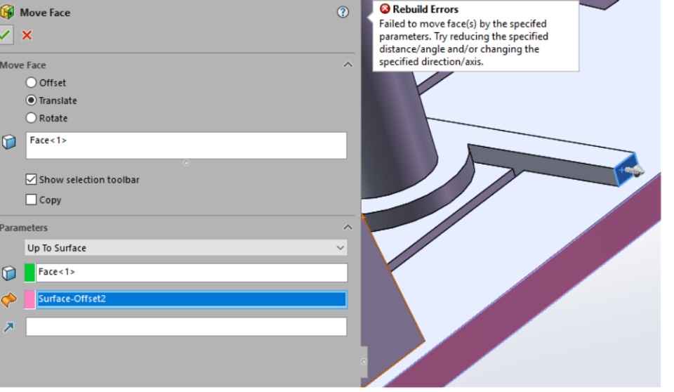

Move Face with "up to surface" option
Would someone here please help me better understand the move face feature with "up to surface" option
How you specify the "to entity" to make sure this feature works everytime
Thank you

i believe so. it does not seem that Move Face was intended to do what you wanted.
DE
DE 2021-04-09
I would suggest using "Replace Face" from the Surfaces tab.
edit for clarity:
In order to use Replace Face you need to have a surface to replace the face with. you can either Knit or Offset Surface (zero offset) to get the desired surface.
or also maybe use Up to Vertex in Move Face instead.

I don't know why it wouldn't be working.  Can you share the model here so that we can get a look at it?  There could be any number of reasons.
JB
JB 2021-04-09
Here is the top view - the "move face" is flat while the "to face" is curve
JB
JB 2021-04-09
Thank you for suggestion. I know "replace face" works but I don't want to create extra surface for the "replacement surface" and I want to understand more about the move face feature

ok i think i figured it out. your feature input is incomplete.
JS
JS 2021-04-09
The reason I mentioned Planer....
Sometimes SW rejects a surface that could have a slight twist or an uneven surface.  I would test it by adding a "New" Surface as the up to, even if it's a Round Partial Circle etc..

tweaking the entity surface  was a way I tried before to make it work
I'd like to understand this features better than "trial and error"
DE
DE 2021-04-09
well i gave it a shot and came up with the same result as you. from reading the help file it seems as though the Move Face feature doesn't work how we think that it should. when it does an offset of a curved face the radius of the face increases or decreases with the distance from the original face. so like how when you offset a radius sketch entity, the radius gets bigger or smaller depending on the offset distance.

Sorry, I just replaced the image in the OP
somehow, the face1 is missing from the screen capture
JB
JB 2021-04-09
Does this mean that the user forces to use the "replace face" instead of "move face"
