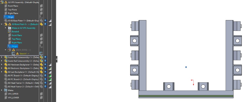

First of all, it appears that when in a sketch, the origin icon (red L symbol) is not actually placed on any relevent origin. See screenshot (highlighted origin for both part & assembly from feature tree for reference).

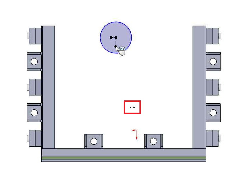

Secondly, I'm working in a sketch & trying to use the modify sketch tool to flip the x/y plane of the sketch. The little flip icon on the mouse is missing when I hover over the dots on the ends of the black L symbol. I am still able to flip both axes at the same time when hovering over the center, but all that really does is rotate 180 degrees. I want to flip just the x or just the y axis. Again, see screenshot.
Side note: what is the little dashed line thingy in the modify sketch screenshot (highlighted in red box)?

I've stopped caring which way the sketch plane face a long time ago, in another CAD.
Hard to tell from your photo.
Part and assembly has different origin.  Unless you model them to be the same.

JB 2021-06-24
you can't flip a sketch direction while editing in the context of the assembly.  You have to open the part in its own window and edit the sketch from there.
