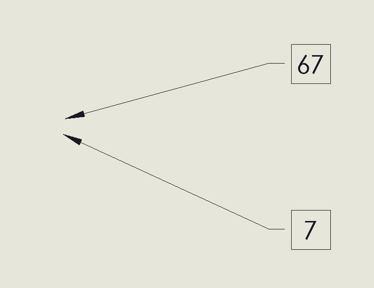

Because we need a Note Box .5 x .5, I need to create a Block.Myquestion to you all, can you create a BLOCK withModifiabletext?(example - Change the 2 to 3 etc...)SolidworksDrawings And Detailing

I wonder if one could create a square and place that in theborder types for note creation? Right now we have the option of -'Pentagon, Circular, Trangle, Hexagon, Box (which is retangular)and Diamond'. It would seem that square would be the next logicalchoice.
I'll submit an enhancement request if you will, because I would usethis all the time in my drawings. But before I do, since I'mworking in SW2006 can someone tell me if this can already beaccomplished in SW2007 or SW2008?

How about creating a Block with an Attribute?

Were as creatting a block with an attribute would be a nicework around, I think the underlying problem of not already having asquare note flag for annotations is rediculous IMHO. Art and Icannot be the only ones who use this square flag.
Art, I'll submit an enhancement request and you should, too.Someone who is using 2007 and/or 2008 please let me know if thisfunction exist.

Yes, this function exists in SW2007 SP2.2 seeattached.

Art, Use a symbol, "Flag Squ", 1-99 or 1.-99.

OK then I won't submit an enhancement request if it exist inlater than SW2006. Thanks.

Art, So, are you satisfied with the answers you received? I suggestedsymbols as a solution but did not hear if this was acceptable. In the symbol catagory, there are also square symbols for lettersA-Z w or w/o a period. The only problem I see is that the size of the square is dependenton the font size. In order to get a .5 x .5 square, the font needsto be .25 inches. To get exactly what you want, you could define your own set ofnumbers/symbols by modifying the "gtol.sym" file.
