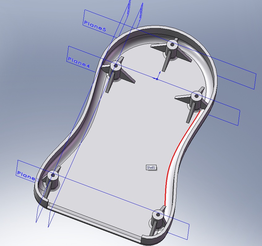

I added some ribs for the first time and it just seemedpretty labor intensive so I wanted to toss this out to see if I amover complicating the process. The attached photo shows the ribs.Essentially I made a plane that intersected each boss, created arib profile (45 degree angle) then used the rib feature. I did thisone at a time (it didn't allow multiple ribs/sketch entities). Itook advantage of symetry where I could.
Is that the way to go about it? Suggestions?

I would have just created one of the stand offs and copiedthe features to the other locations. You can even create a libraryfeature if this is something you are needing in your designs often.A more simplified method would be to go to Insert/FasteningFeature/ Mounting Boss and play with the options there.

In addition to what Dan said, I would be inclined to put a planeparallel to the tops of the bosses and extrude the ribs normal toit. Then add draft to the ends to get your taper. This willprobably require fewer features. I typically just use a standardextrude, not a rib feature, but that is partially because the ribfeature came along after I learned to use the software and seemedto be a bit flaky when I tried it out.

Create an offset surface of about 0.1mm of the part inner facesinto the part BEFORE adding the bosses.
Create the bosses with no hole - one feature
Create the rib in section through the boss - extrude - mid plane -turn merge off.
Pattern BODIES 90 degrees x 1 or x 2 (for bottom one)
Cut the ribs with the offset surface.
Combine
Add holes
Mirror (might need to move the combine after the mirror and mirrorbodies).
BTW I use the rib tool all the time and it is very robust now -especially for networks.

The BOSS feature allows you to make gussets automagicallywhen creating bosses. Its one of those new fangled features that issuppose to make our jobs easier...Ive only used it a couple timesand it might not work in your case, but its there if you want totry.

I would have done one rib, then circular pattern the ribaround the boss, and use a sketch driven pattern to pattern theboss and the rib.
Rib is one of those features that I really like. There are a fewthings that it doesn't do very well, but I think it's prettypowerful.
One of the things I don't like so much about it is the default ribthickness. You can change the default to something other than 10mm, but the only other value you can use is .394 inches.
