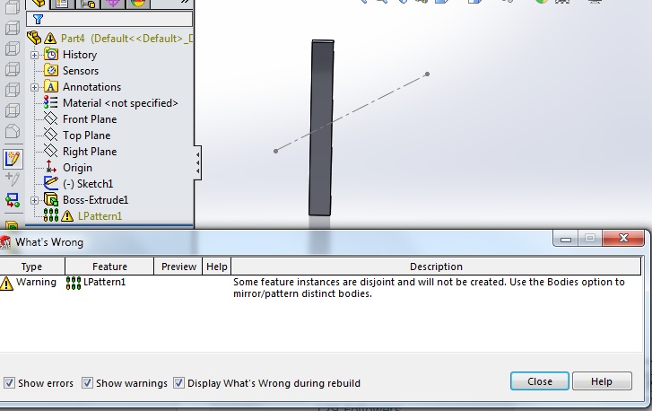

Here's a part that illustrates what I do, I use a linear pattern with the vary sketch option.  Here the length of the posts are 50mm above the construction line.  It simple and works fine, but only when I first extrude a dummy body somewhere which is later deleted.
If I don't do this (and I always forget!) I get this...
Its because there is no option to uncheck 'merge result' on the first extrude.
Just one of those annoying little things??

Im sorry I don't think I explained myself properly, Im using the vary sketch option so need to pattern a feature not a body.
Ive done a slghtly more complcated example where it follows a path to illustrate the behavour Im after
All I'm saying is I have to do an extrude and then delete it to get this to work, If someone can get this working without that I'd love to see it
