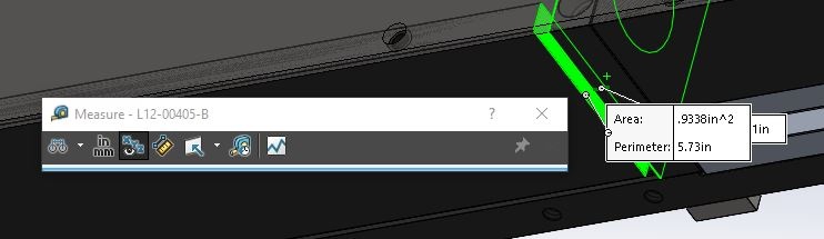

Does anyone know how to get the Measure tool to expand open, picture attached. I can't maximize the window or make it bigger by clicking and dragging. I can't clear measurements so have to close and re-open the tool for each measurement. Any ideas here? I'm also not sure how this happens in the first place?

You should be able to put your cursor on the very bottom edge of the box, so you get the icon with an arrow pointing up and down, then click and drag it down.

Which SW version are you running?
I don't see the expand/collapse chevron to the right of the pushpin as shown in my SW2019 screen shot.

BTW: You can't try Alt+Spacebar to show the System menu because Size is grayed out during a collapse.

​The arrow is there it is just not visible with Dark Mode set.  If you hover the mouse over the top right corner beside the PIN your mouse will change and let you know when you are over the arrow.​

Here is the arrow location! Thanks all!
