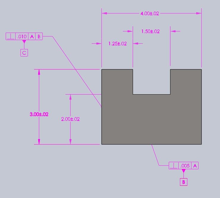

As an example, consider the following (admittedly simple) part, fully dimensioned using DimXpert:

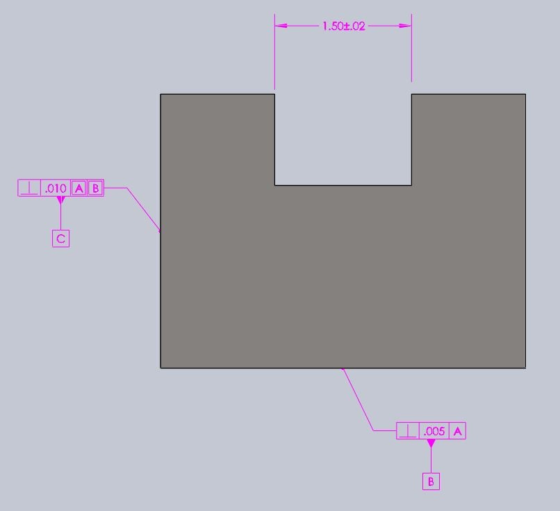

If I apply the proper standards, such as this:
ALL DIMENSIONS ARE INCHES UNLESS OTHERWISE SPECIFIED
DIMENSIONING AND TOLERANCING PER ASME Y14.5 - 2009
FEATURES WITH NO GEOMETRIC TOLERANCE INDICATED SHALL HAVE A PROFILE TOLERANCE ZONE OF   .010    APPLIED
FEATURES WITH NO LOCATIONAL TOLERANCE INDICATED SHALL HAVE A TOLERANCE OF +/-   .020        APPLIED WITH RESPECT TO THE PRIMARY DATUMS [A, B, C] OF THE 3D SOLID MODEL
FEATURES WITH EXPLICIT ANNOTATIONS SHALL HAVE THE FOLLOWING TOLERANCES UNLESS OTHERWISE SPECIFIED:
                                .XX  =  +/-  .01
                               .XXX  =  +/-  .005
                         ANGLES  =  +/-   1  Deg.
The result, I submit, would be this:
