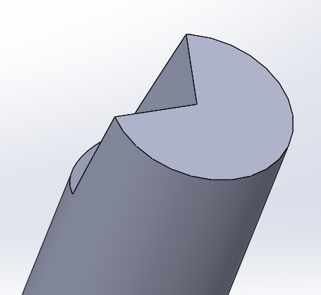

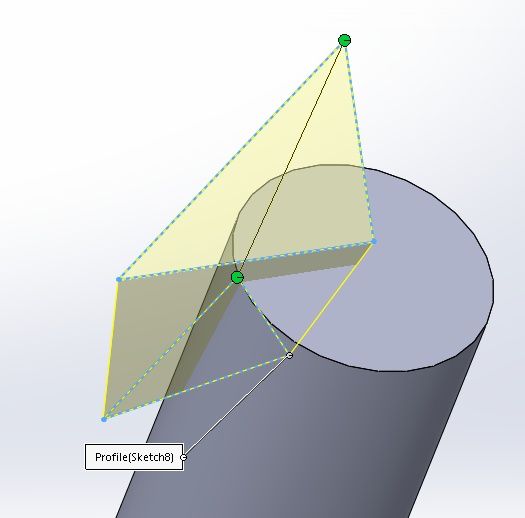

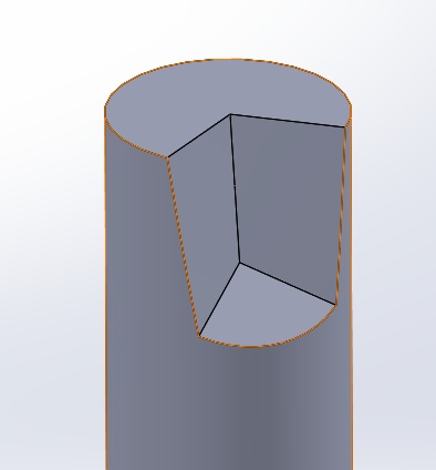

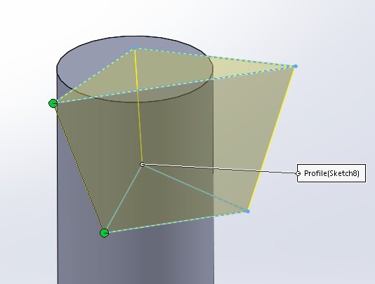

Hello, everyone.
In these pictures, I intended to split the tube into two parts by using particular lofted cut geometry. However, it turned out that the small part of the cut tube (the one inside yellow prism) also disappear, while I actually want to keep all parts as they are placed. How can I keep all parts while can still perform splitting on the tube? What feature should I use actually? Thank you for your kind attention.

Hi,
For this, you can use the intersect tool.
It should find 3 bodies (two you want, one is the remainder of the cutting body). Make sure this last one is excluded and don't merge bodies.
Hope this helps,
Kyle
MN
MN 2021-06-09
Turn yellow prism into surface and use split tool.
