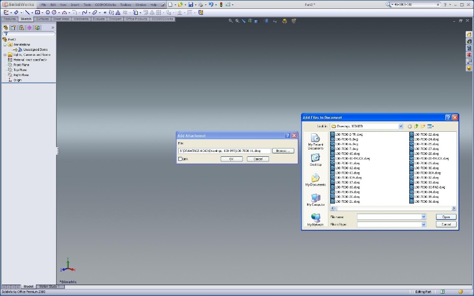

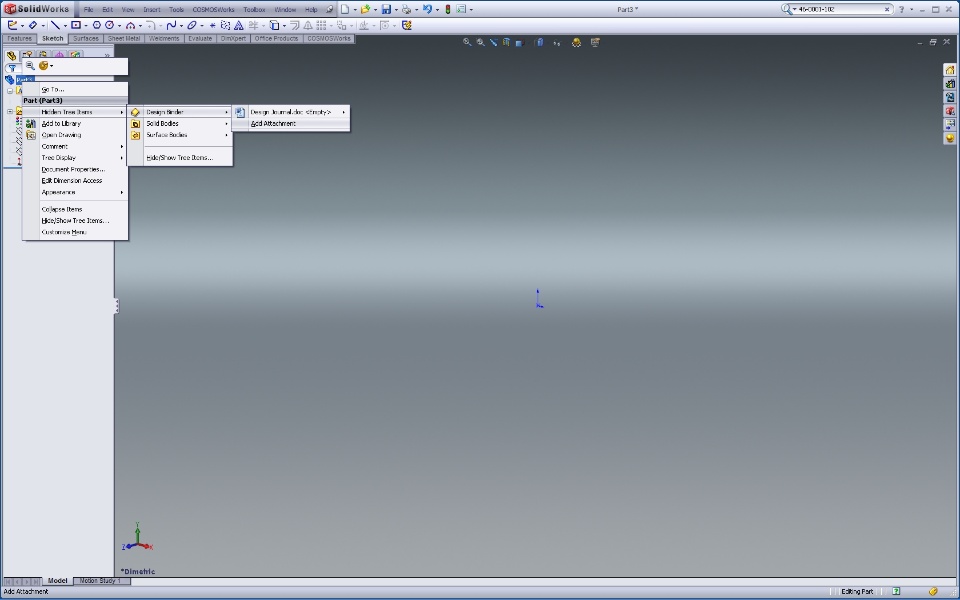

RMB part at top of feature manager design binder then link toACAD drawing as shown but make sure you link the drawing so it goeswith the part when you send it somewhere
Edit:

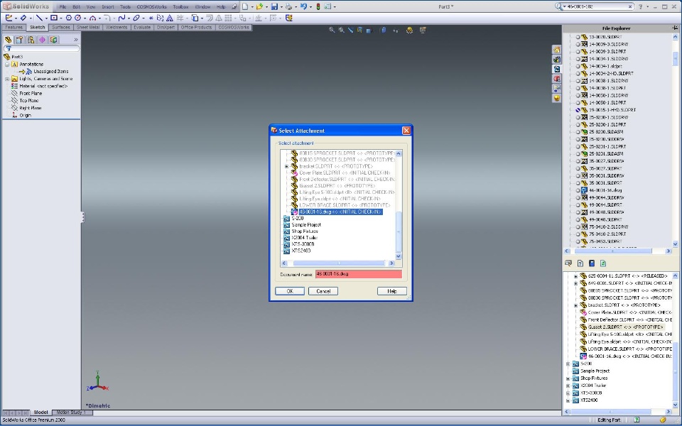

Also you can checkin ACAD drawings if they are visible in your fileexplorer on the right just rmb the ACAD file an choose to checkinthen once it is in the vault you can attach it to your SWpart
