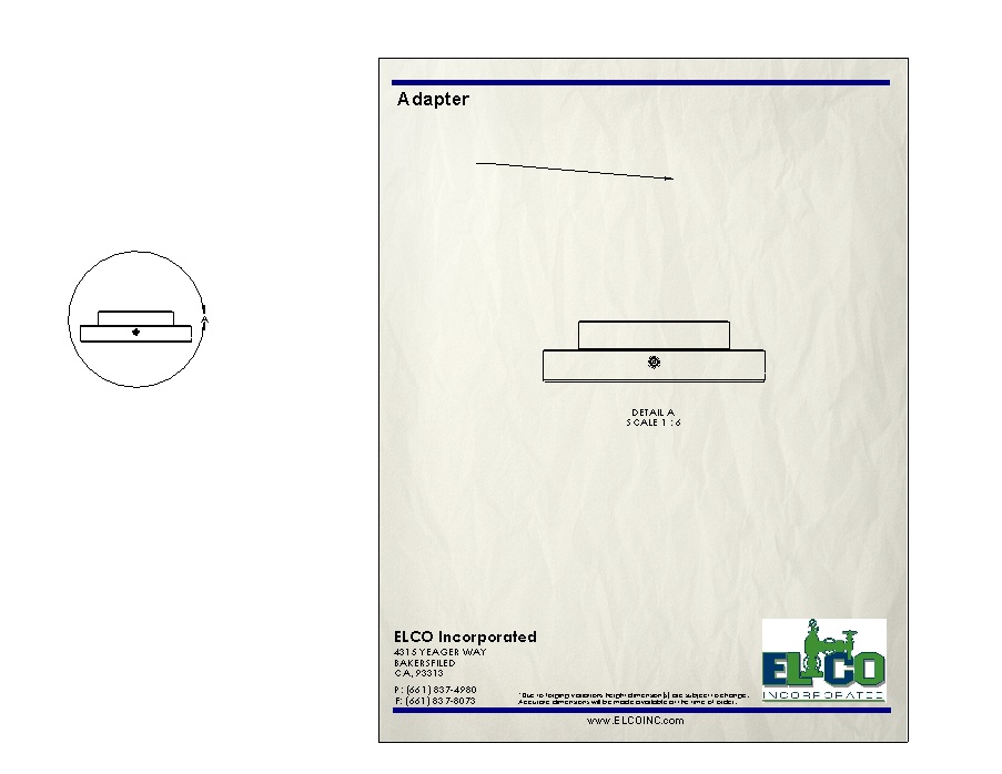

I think what he wants to do is have a note bellow a view thatshow the scale for that view... not the scale for the sheet.
And sorry.. I don't know a way of doing that... although when youcreate a detailed view it does it automataclly... so I guess youcould create the view of the side of the sheet at the sheet scaleand then create a detailed view of it that shows up on the drawing.
