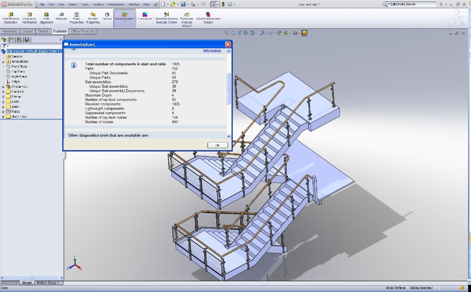

im currently working on a project with 1000+ components andit still runs smoothly.this is with large assembly mode turned off.is this considered a large assembly?
