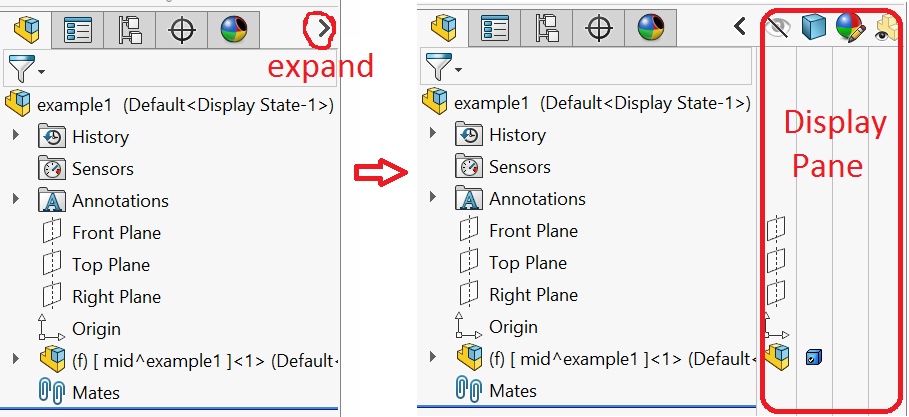

Note: This is the display pane (it is needed to reproduce some of the issues below):

- expand the display pane,
- expand the assembly "mid1^example" and the pattern "LocalLPattern1",
- run the macro.
In the display pane we can see that something went wrong: The two new components do not have any symbols for the appearance (marked red). If we click inside the marked area, SolidWorks crashes.

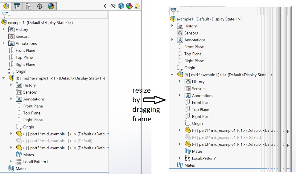

I want to mention another strange behaviour of the display pane. To reproduce it, first close SolidWorks and reopen it. Reopen "example1.sldasm" and macro "issue1.swp" and then
- collapse the display pane,
- run the macro,
- expand the display pane.
Now the display pane does not show any symbols, and if we move/resize it, it "stutters".

2. Changing dimensions in some models lets the display pane "stutter":
In most models I tried, SetConfigurationParams works ok when setting "ordinary" dimensions (which is: not pattern instance numbers).
For some models however, the stuttering display pane issue occurs as well. The reason might be that these models were created in older SolidWorks versions, but I don't know if this is a general rule. My example (example2.sldasm) was created with SolidWorks 2012 (and saved in SolidWorks2016), and the problem occurs. When I built a new model from scratch in SolidWorks2016 similar to that one, the problem did not occur.
To reproduce, open "example2.sldasm" and the macro "issue2.swp" and
- collapse or expand the display pane (does not matter which)
- run the macro,
- (expand the display pane if necessary) resize the display pane.
