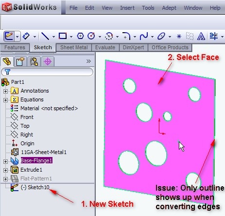

Issue with converting entities, only part outline shows up
I have a part with multiple holes that I want to convert on anew sketch. I seem to remember a way to convert all edges,including geometry inside of a the outer border. We just upgradedto SolidWorks 2008 about 2 weeks ago, so maybe this is a setting inSystem Options that I cant find.
As a workaround, I am using the selection filter to select alledges, but is there a way to do this by default?
See attached screenshot

from what I can tell your workaround is the fastest waypossible. sorry there isn't, or I can't find a faster way...

You can control pick an edge on an inner loop and the face and thenSW will select the whole inner loop for converting edges, but Idon't remember any way to pick multiple discrete edges like in yourscreen shot.
